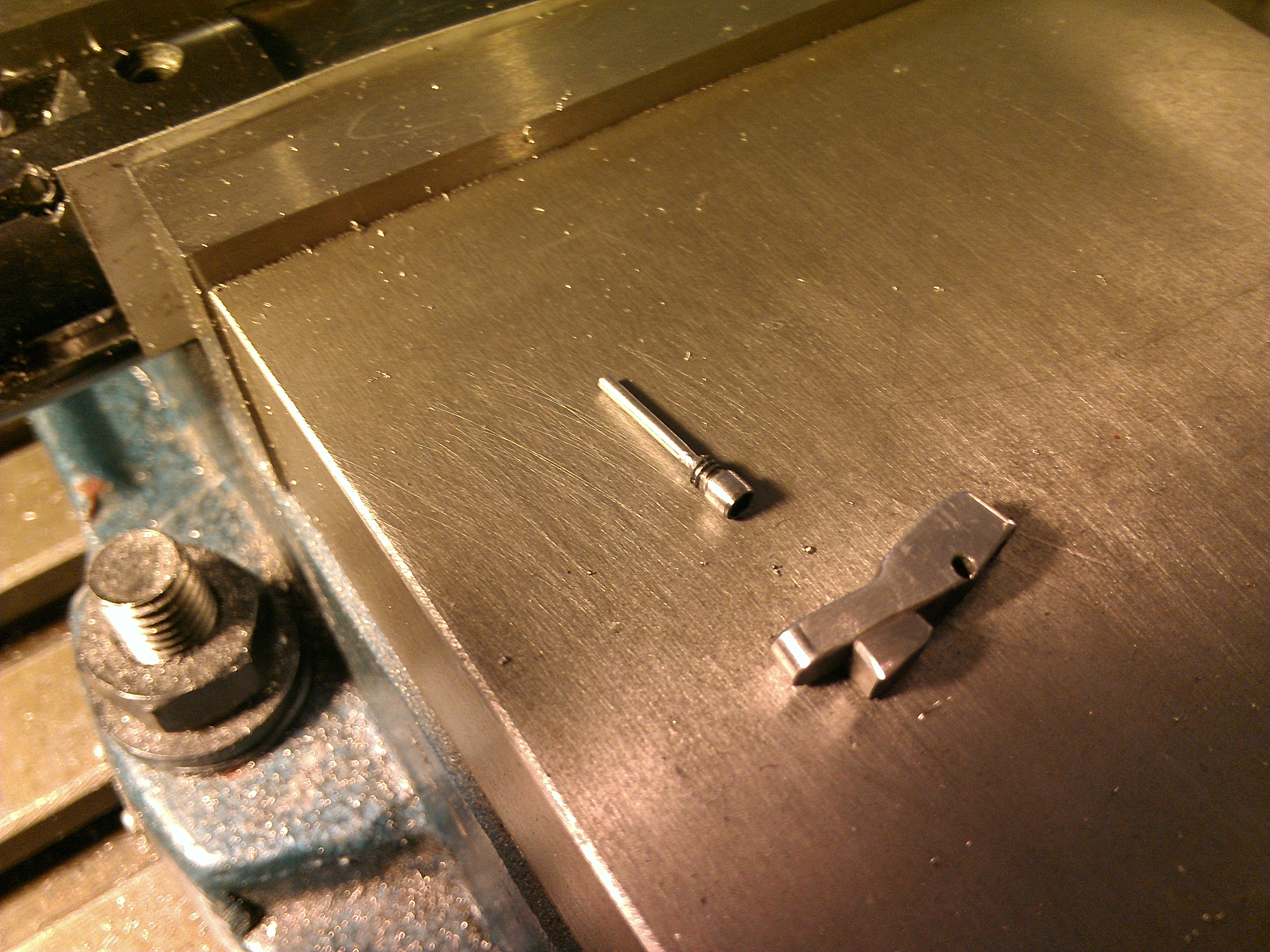

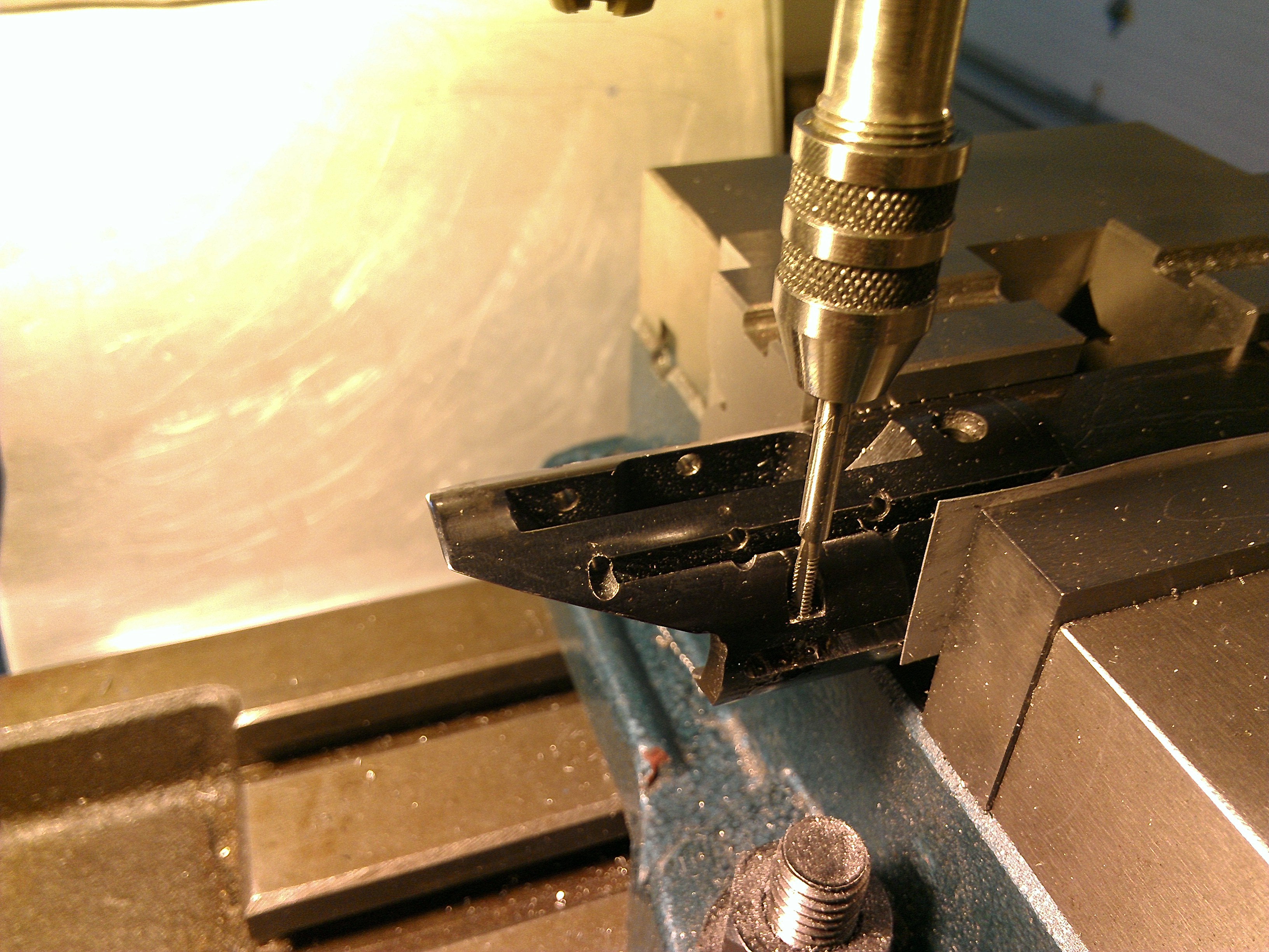

This is the one I did for my XP-100.
Its pretty straight forward. The hardest part is locating the hole for the pin. I used the PTG Lawton/Noster style release. The pin was made out of a 4-40 cap head. I turned off most of the threads and tapped the action to accept and the tip of the pin fits in the blind hole on the other end.
Nice! This is exactly what I'm looking to do on my 40X. Ridgeway, let me study the pics. Is it ok to PM you with any specific questions? Thanks E.
Just be sure that you locate it as far back on your receiver as you can. If not you may not be able to eject a loaded round if necessary.
Very nicely done. Threaded pin is a great idea. 8)

Yeah...clean and no ugly hole on top. I can't take credit for the threaded pin...I got the idea from Butch I think...or somewhere.
