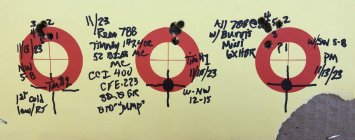

Received and installed the Timney trigger today: average for ten pulls 1#7.4 Oz - compared to the factory 5#, light enough to check for difference. Had time for only a single 5-shot group today - possibly, THE wallet group for this rifle! A little wood removal, and back into the factory "bedding" (45 In. Lb. front & rear) - this was a pleasing reduction from previous groups. That said, I'll shoot a couple more, to verify, then proceed with installing pillars and bedding.
If this proves repeatable, I'll have to confess that Remington was, "doing something right" when this rifle was made. Of course, in this abbreviated testing, only a single powder has been used - hell, H-322; BenchMark; etc., may well shoot even better. o_O I merely wanted a base-line for comparing the "before & after" bedding. Regardless, of where it goes from here, it's obviously a useful varmint exterminator. RG
P.S. shot off Harris bi-pod & rear bunny ear bag.
Final verification groups: last one "blew-up" to a 5/8th in. deal - a nickle just covers it. Still, it appears that despite a rough fore-life, it's worth bedding and discovering if those "fliers" will learn to behave . . . at least, the initial 5-shot group wasn't THE bill-fold group. :p I'd say that the Timney trigger reduced the potential avarage group size by about a bullet diameter. For a guy accustomed to 1.5 ounce triggers, with 1# being as heavy as I like, the 1.5# Timney vs 5# factory, is like a paid vacation.:) The "central thickening" points toward more potential. So, it's off to a pal, for a proper pillaring, while yours truly concentrates on staying above ground and making bullets . . . o_O ;)RG
