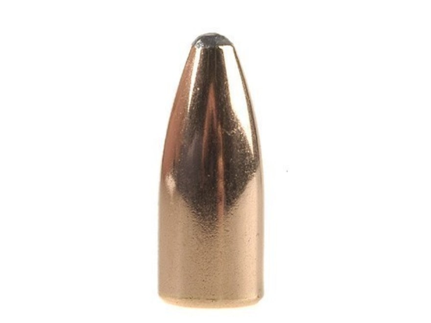

I have recently taken up IHMSA pistol silhouette shooting. I bought an Anschutz Exemplar to shoot the smallbore version. Now I would like to shoot the Field Pistol version too.
The 22 Hornet is the overwhelming favorite due to the low recoil. It is less than optimal for the Rams, sometimes it will leave them standing even with a 55 gr bullet. I ordered some 62gr bullets to try for Rams. Now I am looking for a lighter than 55gr bullet for the first three animals, something 40 to 45 grs.
Inexpensive, < $.15/piece preferred, closer to $.10 would be even better. Oh, accuracy potential too. LOL Doesn't need to be BR potential, MOA or better would suffice. Bulk ok.
Hornet brass is very thin and weak. Flat based bullets are problematic, causing crushed cases. Boattail bullets preferred.
Might keep an eye out for some dog town bullets or some bulk vmaxs…
Also precisionreloading.com has some Speer leadtips in stock right now for 13$/100
No input on cheap lead, but I feel your pain on seating flat based bullets. For my 22 cals I recently switched over to a Frankford arsenal universal seating die and I'll never look back. I measured runout and it's as good as my standard dies, and as long as you make sure the collar is dropped around the neck of the case you'll have no issue seating a bullet. That said, I've never used it on a case as short as a 22 hornet. Maybe if it works for you, Sierra often discounts 22 flat base rounds for 11-13 cents. Shoot me a message if you have any questions about the die, I like spreading the good word since it really resolved my frustrations in seating 40 grain flat base bullets in my swift.

Been shooting 22 Hornet since 1987. Shot tons of flat base bullets with no problem. Your expander ball could be undersized and/or not enough chamfer on case mouth. Putting the seater die farther into the press and back the seater stem out might help as well.
Not sure of your seating die - but a die that supports the bullet and case to ensure concentricity should seat a flat base easily - maybe a Redding match seater or similar.
Check out Speer's, Nosler 2nd (Shooters Pro Shop) and either of the Varmint Nightmares( Midsouth Shooters) or Dogtown (MidwayUSA). about the best price's you will find and they will surprise you on how accurate they can be. Try a few of each and see what your rifle likes best, then go for more.

I load for the bee..same thing .I use a 30 cal fmj bullet to tap lightly expand case mouth to allow for fb bullet ie sierra 45gr..and then the die closes on seating....lightly ...just edge of case mouth.
Nosler 52 Custom competition bullets on sale at Powder Valley for around $16.00/100. Hard to beat that in a half-way decent target bullet!
