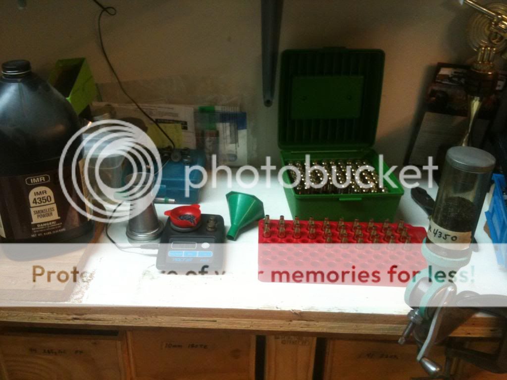

I came home and weighed some of my thrown charges. I am getting .6 grain variation despite have a consistent "throw" technique. My question is, should I weigh each charge for best results? Will my velocity ES tighten up? Thoughts??

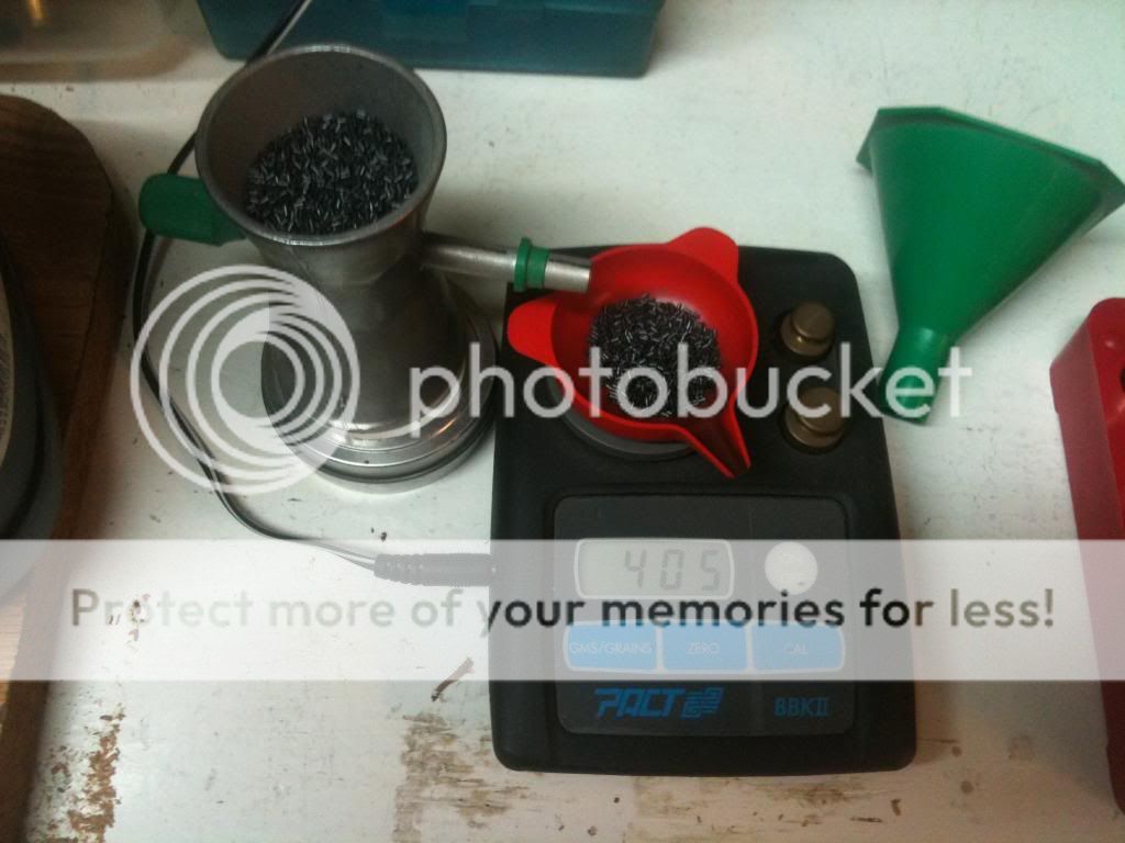

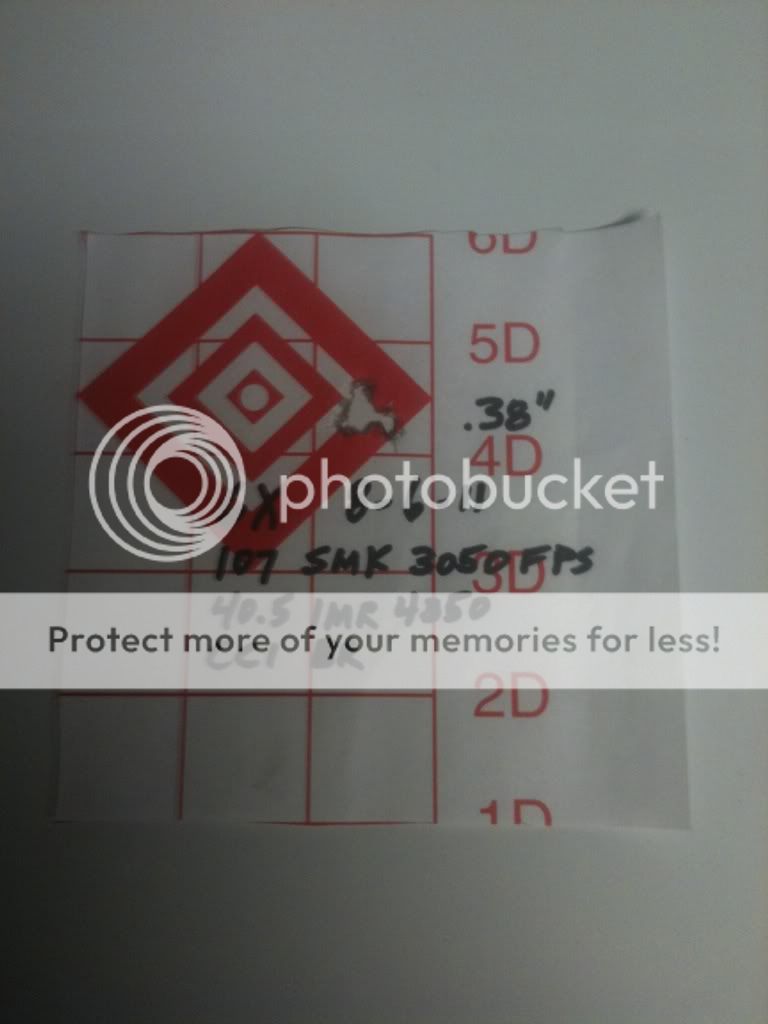

I adjusted my measure down and threw low and trickled up to 40.5 gr with my Pact Electronic scale. With IMR 4350 my ES in my 6X dropped to 25 fps. My last group of the day was .38" in getting hot and sticky conditions.
