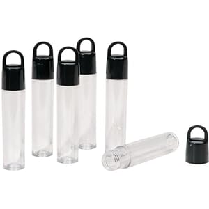

The other was these:
Amazon, free shipping about $7 for six. I have a dozen, that will get me though a range session with my ML.
Oh yea, Milo, I think part of the problem with powder sticking to the plugs may have been that some were used :P
I have not loaded at the range bit I do have these same containers for blunder bust..I would go this route
