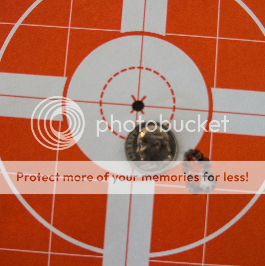

Reference IMR's new 4166 powder, for those who have been thinking of trying it with .308 Winchester loads.
My 1 in 10 Criterion barreled .308 had been shooting the 175 SMK's with IMR 4064 great at 100yds. but, i disliked throwing the charges with those huge sticks, understood it to be temp sensitive, and it's kind of dirty.
i was therefore on the look out for something to replace it without the negatives and not having to depend on Varget availability. also, in my rifle, Varget shot well but not as good as i thought it should. i saw some buzz on the forums here about IMR's new 4166 and decided to give it a try.
long story short, after a quick ladder test last weekend, (at 100 yds unfortunately, welcome to South Florida's long range shooting issues) i took it out today with 175 SMK's on a perfect light wind day and was very, very happy with the results. shot two different loads (20 rounds, all 5 shot groups) and the worst was just over a half inch, with the other three groups at .25", .29", and .305".
next weekend, we are making the 4 hour drive to the nearest public range that you can shoot out to a thousand, and am going to give this combo a try at 600 yards.
