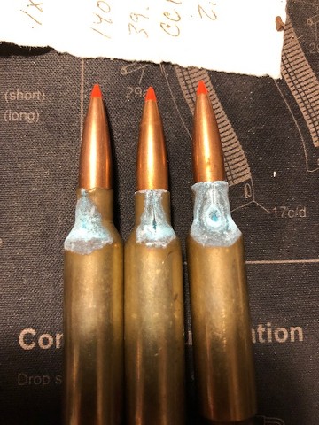

This past year I went to check on some loads I made years earlier and this is what I found...
I was able to pull the bullets but the brass was brittle. Some of the necks pull off with the bullets. I lost about 300 pieces of 6.5CM brass and had to toss about 200 rounds of .308 Win as well.
