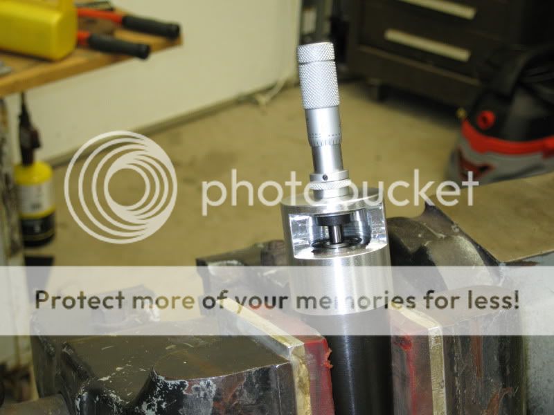

If you don't have one of these you might consider making one prior to chambering your barrel. Makes the job considerably easier. You can check your headspace with the gauge right in the lathe. You don't need the window in the side of the thing.
Thats why everybody needs 2 lathes. Always something needing to be made after you get one indicated
