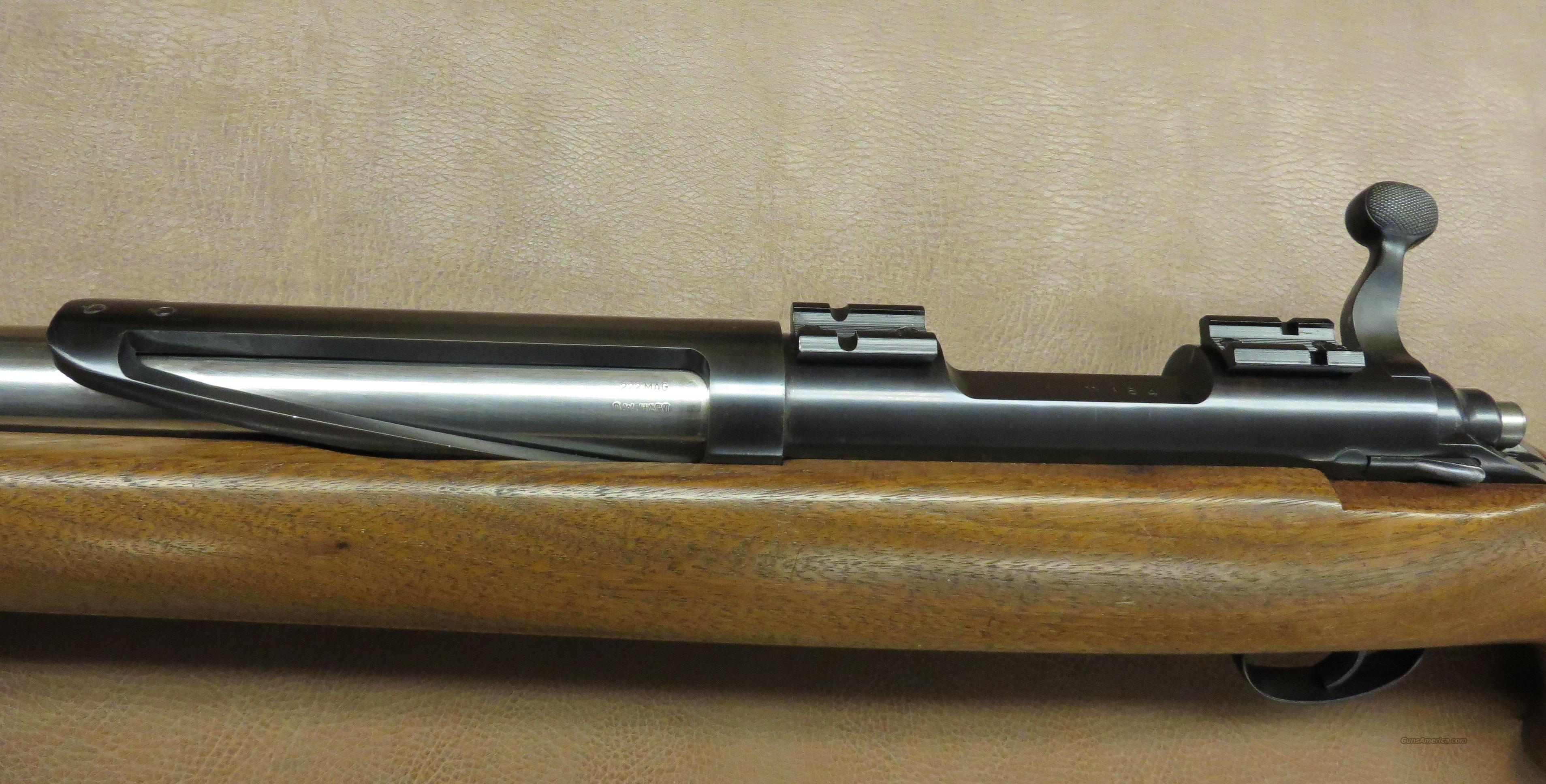

This is what your action would look like if it had the scope mount extension threaded on. It's been 35 or 40 years since I've seen one of those, so I don't remember the specifics of all the different models. I remember there was a Model 1, and I think a 1A. I think there were another couple of actions in the lineup as well, but can't recall their specs. I know there was a Model 4 that was used for the early unlimited bag guns that mostly wore wood stocks and Unertl, Lyman or possibly a Remington (rare) externally adjusted scopes. Ring spacing necessitated the extended portion of the action. They were nice actions in their time and will likely do some quality work for you today.
