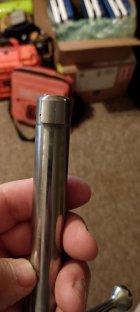

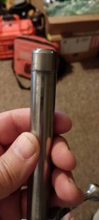

Jackie did that bolt have any test marks on the lugs. I've got a Farley that's my vfs rifle and love it mine has as test mark on each lug and one on the bolt body. It's probably my favorite rifle actually came from Texas.
no it did not.
If yours has Rockwell C marks on it, somebody tested it. Here are two on one of my boltsimage.jpgIMG_2684.jpeg
Thank you guys for posting the pictures of the test marks on your bolts. I just checked the lugs on my black widow bolt and there are 2 dimples the one lug but they’re small. I had to use a loupe to see them clearly. I’ve been a little concerned since last year at the super shoot when a fellow competitor seen my Farley and told me about his lugs shearing off. It’s too pretty and accurate to sit in the safe.
