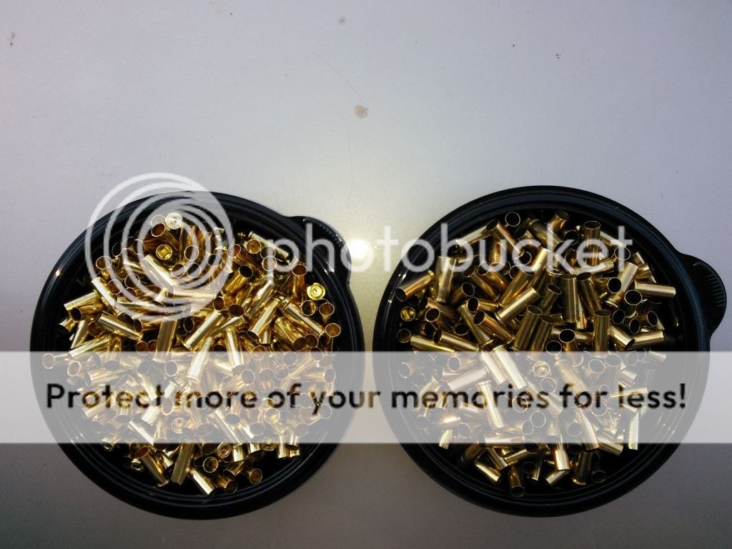

It's the Lemi-Shine that gives the brass its high sparkling shine (some use different citric acid based products). I recently wet tumbled a batch and forgot to add the Lemi-Shine. Although the brasses came out clean, they did not spakle with that high brassy shine. I use 1/4 TSP per batch.
I took a snap of the batch with and without Lemi-Shine, below. Batch size and tumbling time were the same. Auto wash & wax is used for the detergent agent.
