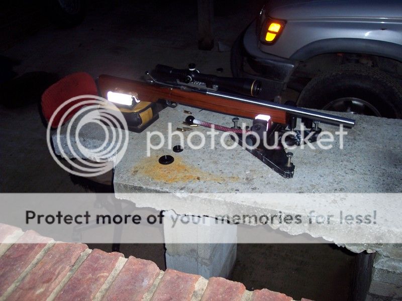

pic of my personal home bench,,my load bench is just inside the basement door,,
my home range goes to 330 yards but is setup at 100 in this pic
