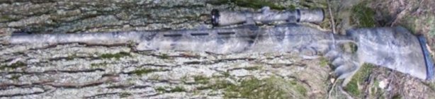

I paint my Tikka camoflage-
Nice job! Blends in really well!

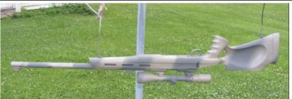

Here's the last one I did, was a Manners plain jane tan to begin with.
I painted it 1st with flat black, then overlayed shelf liner & spritzed it with silver to mimic carbon fiber, then sponged on the brown & tan. Either the brown wasn't dark enough, or the tan wasn't light enough for better contrast, oh well....
