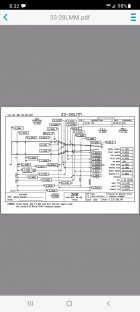

Just got my 33-28 nosler reamer in and should have my rifle back in 2 weeks JGS throated for berger 300 otms with a turn kneck. Just need help with starting charges 2800 to 2850Fps is my goal.
I have H1000,Retumbo, rl33,7828,rl26,8133 and maybe VV n570 to work with.
Dont have my dummy round available to measure but it should be around 3.5 to 3.7 and a 28" 1in9.3 bartlein barrel
Thanks

28 nosler necked up
Berger part #33109
I will have to call my Smith tomorrow just use 3.6 for over all length that is at the far end of what i have spec'd for my reamer

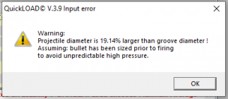

I feel like something is "wrong" here. With those entering values, I get this error with every recalculation:
... and every powder shows dangerous pressure signs at really low velocities.
Anyway ... here are the first five powder, the last one is the same issue but I can only include six files (5 powders and the error screen).

Yea data's not right somewere thats like win mag speeds i dont know thanks for your time anyways ill give it the ol'Roy Weatherbey treatment
Like Rusty, I used the .28 Nosler as the starting baseline (.33-28 Nosler not being in the QL database). Since these are manual entries, you'll want to double-check what has been input. Groove diameter and the Cross-sectional Bore Area are from the .33 Nosler.
