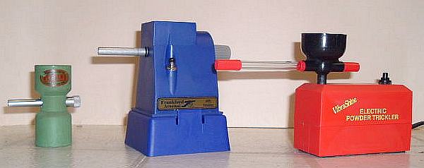

I need to buy a new powder trickler with a much longer drop tube that will reach the powder pan while it is sitting in the center on my MXX-123.
Chuck
Chuck, the Vibrashine powered powder trickler will reach. Danny Reever has one for sale in the classifieds. You may have to raise the base a bit.
I've seen some guys put a piece of plastic tubing on the manual tricklers but I can't say how well that works.
Chuck,
I had the same problem with my RCBS trickler, what I did was find a straight piece of tubing the same size and cut it to length and ran a tap down it to get the auger effect, and attached the handle and collar from my RCBS. Works pretty good.
Jeff
Jeff,
Great idea my trickler is a RCBS also.
If Danny still has the Vibrashine for sale I will buy it.
Thanks...Paul
Chuck
Will workjust fine with a mxx123. Just raise it a little. I've had a VibraShine trickler since I first started reloading. One of my better buys. You'll like it.
