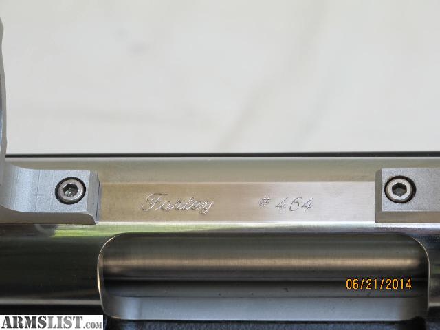

I need Davidson type bases for older Farley action
can anybody drill the holes in a Davidson base blank to fit my old Farley action that has about a 3/8ths wide flat the length of the top of the action,,all one piece and with no MOA taper??
I can get the blank from Sinclairs but dont know the measurements or where to get them??
thanx eric
it is made just like the action in this picture I found on the net,,mine has a Nightforce Pic rail someone machined about a 25 MOA taper on and I didnt want to take apart to get pics,,
I would like to try the Davidson base with Harrells offset rings,,
Line up and clamp new and old rail together bottom to bottom use the correct size transfer punch to mark holes on new rail and drill in drill press. That's what I would do.
