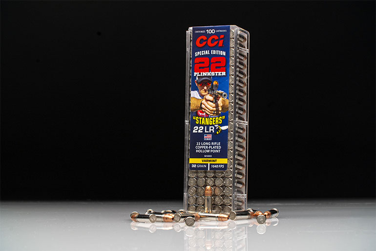

Grandmothers in wheelchairs may not be fast, it's all relative. There's nothing wrong with calling a CCI Stinger a hyper velocity .22LR round because any time that caliber produces MVs like Stinger's nominal 1640 fps it's not simply high velocity.
CCI Stinger rounds have a longer case than other .22LR cartridges. That allows for more propellant. The lighter 32 grain bullet also helps achieve higher velocities.

Who’s picture is on it?
