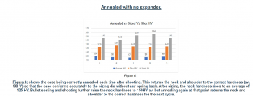

I went to the AMPS website. They had exactlly the info I was looking for. Sizing, shooting and annealing the same case 5 times. Hardness testing 15 times. The case returned to extremely close to the original hardness each time. I assume it isn't copywrited to post. It shows the great work they do. Good advertizing.
