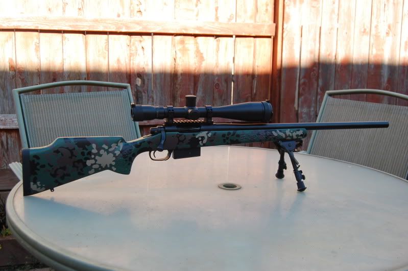

I have a 6BR that has take an antelope using the 105 Bergers Hunting VLD. My rifle is a Stiller Predator (I like the Stiller action as it uses the mini M16 extractor - seems to eject more reliably than a Remmy factory one). 24" 1:8 twist Kreiger Rem Varmint Contour with an AICS DBM in a Manners MCS-T stock. Here is is before I put it in another molded-in MCS-T
FWIW, the Berger was devastating. Made complete soup out of the vitals
