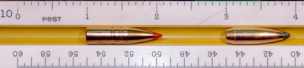

I bought a bunch and shot my first today from my 6X45-caliber AR15. Of course the AR15 format with its original-length case won't let you seat these long bullets out where they belong, but they still work just finely.*
Being all-copper**, they're long at 1.104" for their weight compared with the Speer soft-point boattail at 0.986".

The blem bullets are advertised as flat base. I don't have much experience in lead free bullets but aren't the 6mm 80 grain GMX bullets made with a boat tail profile?
Apparently some are, some aren't.
Nov. 02: And here's a pic of the full-price Hornady 80g. GMX; looks to me to be the same as the factory-second.
None of those illustrations appear to be a flat base bullet to my eyes, such as a Speer Hot-Cor.
ETA: This looks more like a photo than an artist rendering to my eyes.
