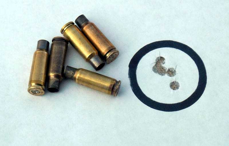

I purchased a Howa Mini 6.5 Grendel barreled action from Brownells. I pillar bedded it into a Boyd's stock, installed the aluminum bottom metal and trigger guard and changed the trigger springs. I mounted a 6x24 Nikon scope.
From a bipod it will shoot about 1/2 inch at 100 yards and 3-4 inches at 500 yards. I'm shooting XBR 8208 powder, CCI BR4 primers and 123 grain SMK's jumped .010. Velocity is around 2450 fps. I have to single load since this combination is to long for the magazine but it doesn't lose much by seating the bullet deeper to fit the magazine.

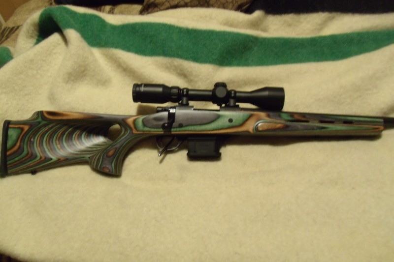

Got one from Brownells, just the Barreled action. Took the 6.5 Grendel barrel off and tossed it in the scrap pile and had it chambered up in 6mm Fat Rat and also a 224 Grendal Barrel. Put it in a Boyds Pro Varmint. Its a Hammer. 88 ELD at 3000fps.
I have a new Chassis system, should be here in a couple of days.

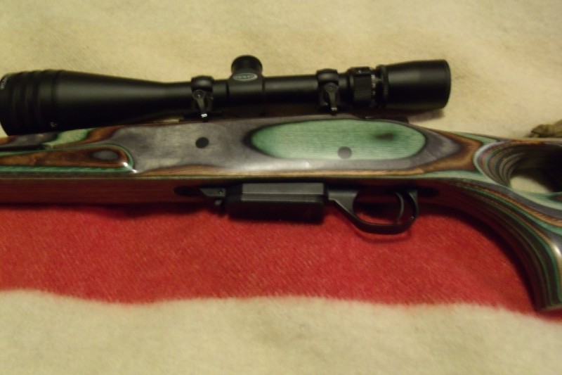

I bought a 6.5 G HB barreled action and dropped it into a Boyds stock, nice shooter.
I bobbed the mag and release, then added more scope. Fun rig for PD's with 85gr HP's
