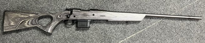

I'm mostly a long action guy, but a nifty howa mini build caught my eye and got me wondering. Does anyone know what the max OAL length is for the mini magazines, and maybe the max cartridge size/diameter? Could you get a barrel chambered in 223 wssm to fit, or something similar?
Howa Min action:
  • Mini Action Calibers: .223 REM, 6.5 GRENDEL, 7.62×39 & 350 Legend
So if you bought a mimi Action w bolt the AR-15 cartridges based on the 223 or 7.62x39 could be used with a rebarrel, like the 6mm TCU, 6mm Mongoose, 6.5 Grendel, etc.
22mm, 0.866" barrel tenon, 0.616" bolt body, so 7.62X39 case heads are a good upper limit on diameter.
The Howa 7.62X39 magazine has an internal length of 2.35".
Well the 7.62x39 is an 11.35mm/.447in case head... and the 223 wssm is 14.1/.555 . So that kind of squashes that plan. I guess that's why one of the chamberings was 22 ARC. I figured that it might be fun to build one of these with a 14in 224 barrel with a 1/7 twist. I thought bumping up from a 223 to something bigger would help regain some of the velocity lost by both shortening the barrel and going with heavy pills.
I may need to reconsider. I'm wondering how useful it would be to have a mini over just getting a normal action where I wouldn't be quite as limited. Still, I see the howa actions on sale every now and then, so they are tempting.
