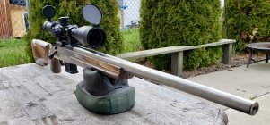

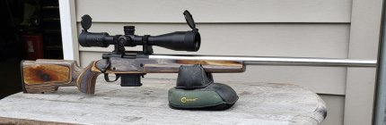

Here’s one of my Howa Minis in a Boyd’s Pro Varminter stock with custom 20 PPC barrel. Gunbloke springs, aluminum bottom metal, and aluminum magazine floor plate. Have another mini barreled action in the safe but haven’t done anything with it yet.
