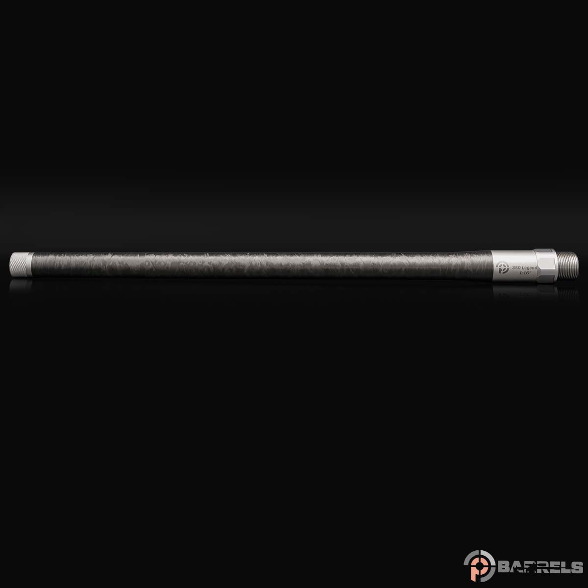

If you’re going jam nut prefit, Check these sites out.
These people will make a variable shoulder or a fixed shoulder for you and attach it for an extra $125
These guys use x caliber and shilen blanks, and can do a shouldered or variable shoulder.
This guy has a huge selection of blanks, and can make you a variable shoulder barrel as well. Not sure on his price though.
Again, any smith can do this for you, but these guys are a lot cheaper.
