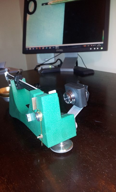

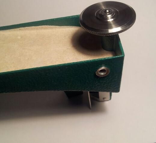

Here's another couple of pics about blinging up your scales.

Upgraded level adjuster.
Webcam mount.
