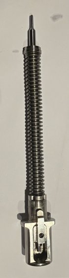

I make my own BAT DS pins (0.280 size) and use a 24lb spring (pictured below)
Nice work.
What material do you use to make the firing pin.?
