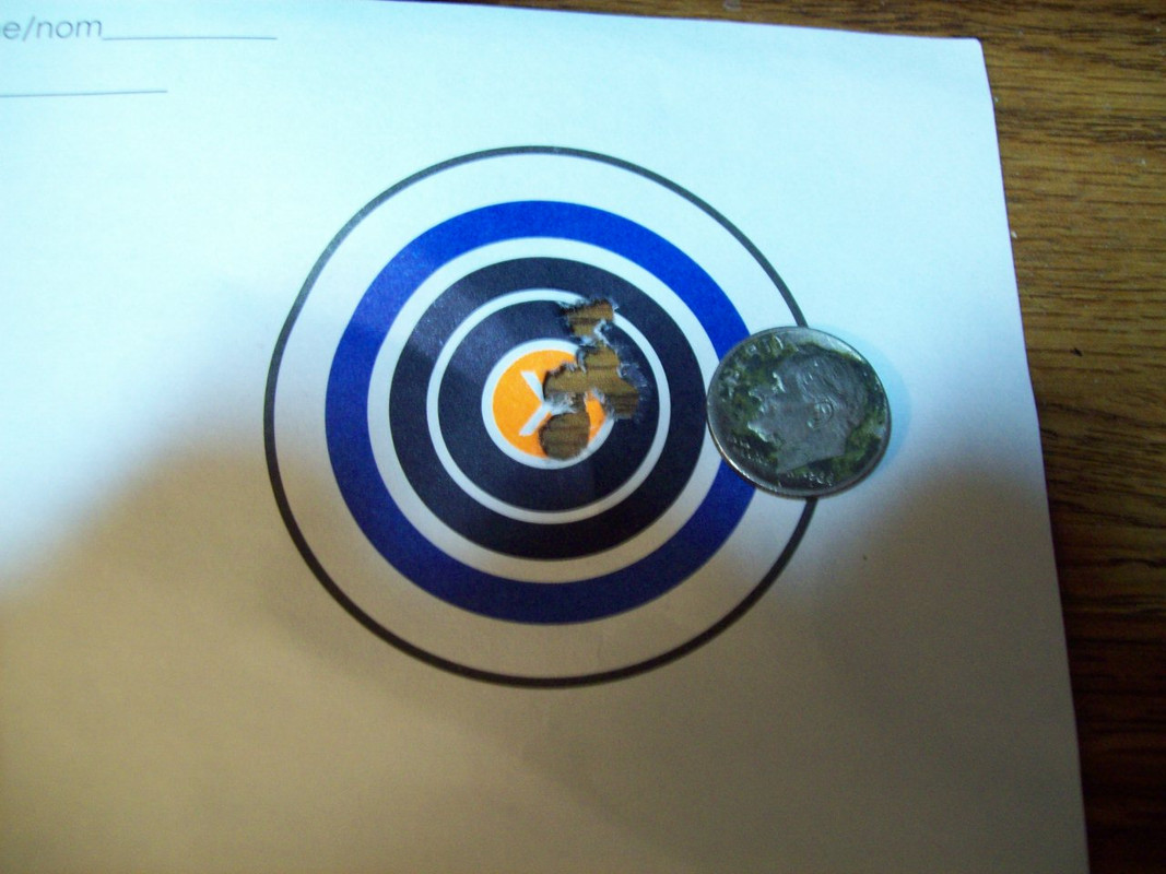

Here is one of my setups. Group shot at 100 yards
Hope this helps and Merry Christmas
Doug
