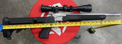

How to hold a TC Contender barrel for threading.
I would gladly pay for a bearing steady if someone would make me one.
I'm seriously considering it after looking at these pics.

I'm sure the question of why would anybody want to mess with these Encore/Contenders, shorten, thread. And those are threaded. Makes a pretty handy suppressed rifle out of a box blind. Any better youth rifle?
