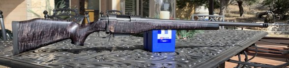

Take a minute and consider a clear epoxy coating. You’ll need a spinner (think barbecue rotisserie) to keep it from running, but it’s pretty bullet proof when done. Here’s my most recent example of the finish. I dulled it down from high gloss.
I’ve been cutting finger grooves into most of my personal stock. Try them before you remove them.
Nice looking stock!
I have had some of my best stock finishes ever by taking clear epoxy and applying it somewhat like you would Tru-oil. No shrinkage, so the grain fills almost immediately, and in about 3 coats it is ready for final wet sanding.
It is tough to sand down the first coat, but as I see it, if it sands down easily, it will scuff and scratch easily. It is the toughest finish I have ever used, and the effort required to sand smooth bears that out.
