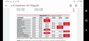

You would think so. I'm just trying to find out what caused this one. This rifle has less than 100 rounds fired from it. I'm pretty sure it has to do with my loads using the 153 gr ATips, as I've shot 40 or so Hornady Black and elds, along with another 40 handloads using the 140 gr ELD-Ms. The pdf I tried to attach was for 147-153 gr bullets, and shows 42.9 gr Superformance as max load.
