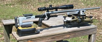

I also have 3 Savage's, 2, model 12 and 1, model 110 that I set up for 600 and 1000 yd shooting.
My first was a used 6.5 CM and started the long range rabbit hole with that 4 years ago.
My first model 12 was bone stock and with my reloading and testing I was able to get 6" groups at 600 yds. After I shot out the barrel I put a Wilson barrel on it. My shooting still was getting better. Then I went full bore, Boyd's AT-one stock, timiney trigger, bedded and pillerd the action.
I'm on my 3rd barrel now (Brux) and it shoots 6.9" groups at 1000 yds.
Then I decided to get a second gun. Again bought a old used Savage 110 in .308. Rebarreld to 6mm CM and changed out the stock, trigger and beaded the action. I'm on my 2nd barrel with it.
Since my modifications moved my gun into Light Gun specs I bought another Used Model 12, 6.5 CM and I am keeping it stock so I can shoot factory gun on 600.
For what I have invested in my guns I can still shoot with the big boys that have $5 - $10K in their guns.
Don't count the Savage actions out. Yes some are sloppy and some have firing pin issues and need have the bolt head bushed, but you didn't spend $1k for the action and more for a barrel.
If your just getting into long range shoot the gun and test you reloads to find the node and Jump for what it likes. You will know when it needs some adjustment as I have found that mine like to shoot dirty (300-400 rounds between cleaning). Checking the chamber for errosion around each 200 rounds will keep you bullet jump where it likes to be.
Savages are so easy to change out the barrel (about 30 mins) and barrels are not going to send you to the bank for a second loan on your home.
pics are 1st model 12 and then progression to my second gun in 6mm CM
