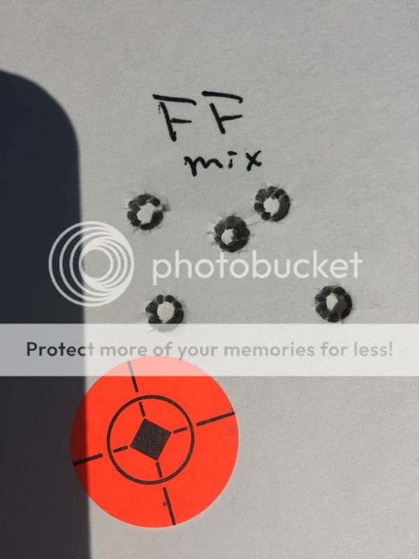

i had an eye opening experience yesterday morning. As I was load developing for why I call Stubby (26" 6 JDP) I had some fire form loads I needed to run thru as well so after I finished up my old developing tests at 300 yards I shot this 5 shot group with junk Bullets, and what I mean by junk is they are pulls dropped Bullets of all sorts of weights and styles. Weights ranged from 103-108 and I shot BT VLD, hybrids and some VT I had laying around. Nothing special on seating depth at all just grabbed them out of my junk bullet pan and seated them.
They all were shot using 31.0 grains of Varget and a BR4 primer.
FF at 300 yards
For some that may say it's a fluke. Here's another 5 shot 300 yard group
Ok and some gonna say what's it going to do further out? Well after my testing at 300 I went to 600 yards testing yesterday evening. After my testing I had some more fire form loads to shoot thru. So I got a good zero with the loads and 8 out of 10 shots hit a 2" swinger dead center 1 shot hit the stem of the swinger roughly 2" high and the other missed all together.
