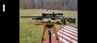

Below is my 6.5-284.
My 6.5-284 is not my lightest weight (8 pounds) hunting XP-100, but I had it handy.
It shoots amazing, even at distance with 140 AB's: 2784 fps (distance was 575 yards on 10" steel)

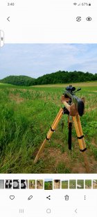

One of my better shots off the tripod.
Gave him a couple warning shots to get him up to speed, & rolled him at close to 400 yards, just when he cleared the top.
The arrow points to the clump of brush I was set up at:
