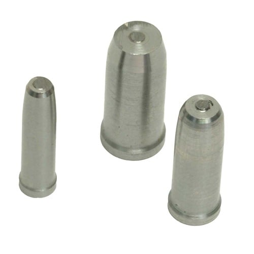

Yes, it's a very good idea to measure YOUR exact chamber length. PPC being a wildcat, can be quite a bit different from one reamer to another. There's no right or wrong about it, just different and you don't want your brass to be too long in your respective chamber, creating potentially very high pressures. It's just a very good practice to check this on every chamber/bbl, for safety. I've got ppc reamers both long and short. I think the shortest is 1.500 and the longest 1.520. So there can be enough difference to cause problems if one just assumes their chamber is the longer variation. It's a good idea, IMHO, to know the actual length on every chamber, not just a ppc.
These are cheap and easy to use but are limited in regard to what neck diameters are available. I usually make my own from aluminum or brass.
1.505 trim back to 1.490
chamber measures 1.515 I think
have to be careful as the above post explained
