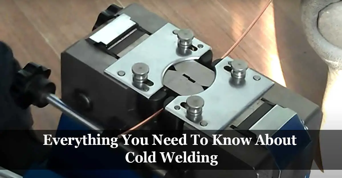

I have seen cold welding performed to seal electronic cases.
This article does a decent job explaining the process.
Here is a link that offers anouther possibility
