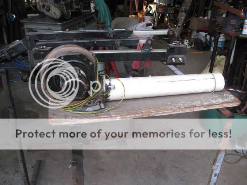

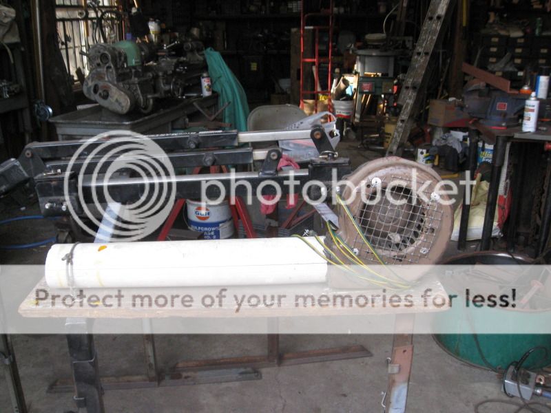

This is a cooler that I built so I could zero to a cold barrel thirty years ago, wore out several motors:

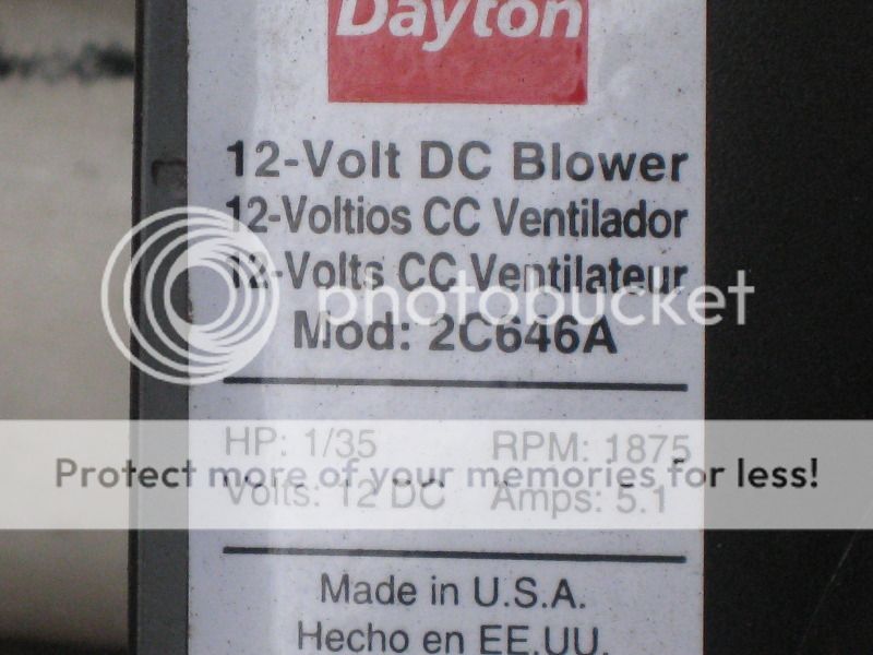

This is available from Grainger:
