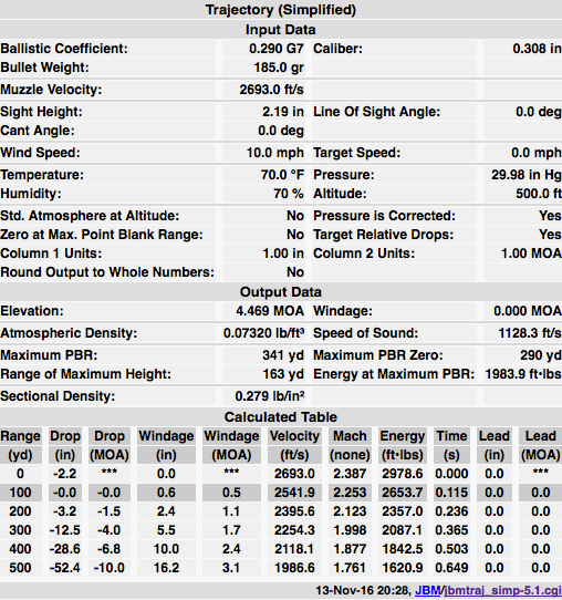

It's fairly easy to calculate a [theoretical] value for this solely based on velocity using a ballistic program, such as JBM. The following is for a .308 Juggernaut load with avg MV of 2750 fps. You raise/drop the velocity until the drop is +/- 0.5 MOA at 500 yd for a 1 MOA 10-ring (i.e. - find the max/min MV that will give a total 1.0 MOA vertical change at 500 yd). For the above 185 load, the ES comes out to be 114 fps (+/- 57 fps)

If you look closely, the two examples you show have a different launch angle 4.469 MOA vs 4.278 MOA. If you turn off Elevation Correction for zero range, then the answers are a little less generous.

Yes - I was in a hurry and that was just a quick and rough estimate to get total MV spread that would give you approximately 1 MOA vertical at 500 yd. You're right, it's better not to correct for zero at 100 yd, but realistically, a ~50 fps change in velocity isn't going to change the 100 yd zero very much as indicated. However, the total velocity spread for 1.0 MOA vertical at 500 yd for that load would actually be slightly less than 114 fps. Corrected, it comes out to +/- 48 fps, rather than 57 fps, or 96 fps ES. In the grand scheme of things, that difference is really irrelevant because it's still almost 100 fps ES, a much larger value than some might have expected. That same ES would give somewhere in the neighborhood of 2.6 MOA vertical at 1000 yd. The more interesting question is...exactly what was the ES value you measured?
To do this properly, you need to set the elevation (in MOA) as constant rather than the zero range.
You really want to know how impact changes with velocity without the scope being rezeroed.
