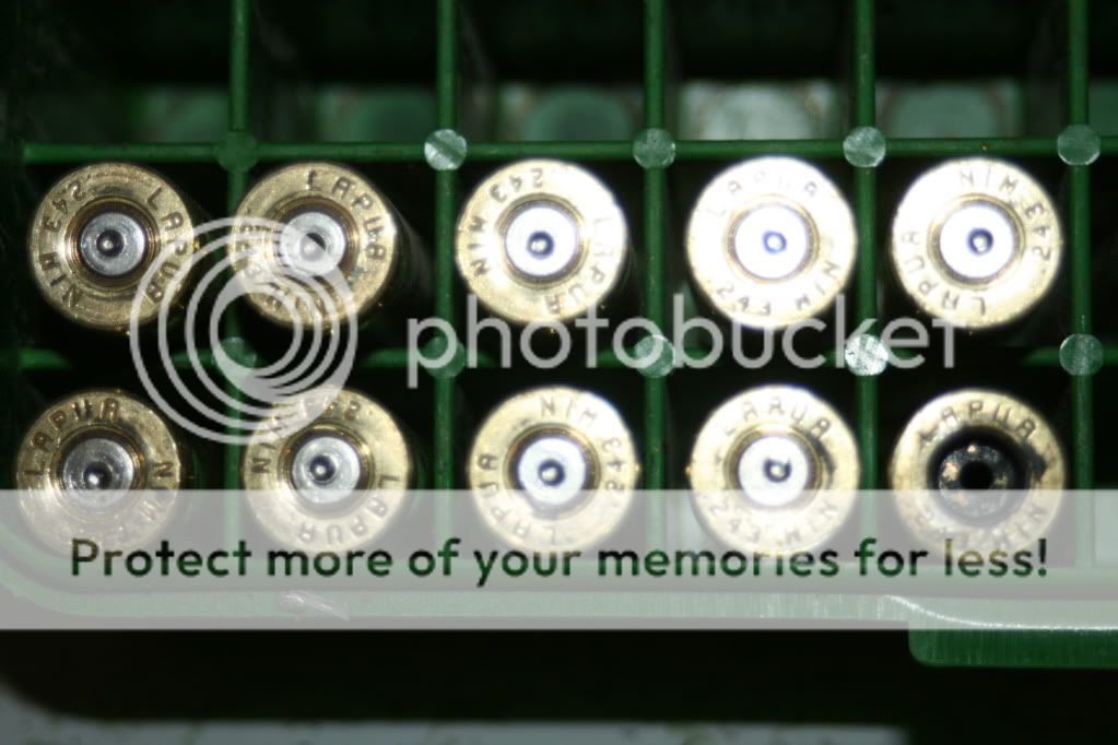

I've run the ladder test and came up with my high and low node with H4350 and 140Amaxs. Low node is 40.8grs at 2600fps and high node is 43.4grs at 2950 fps. To me 2600fps is too slow to optimize the BC of the 140s. I think the 43.4grs in right on the edge of being to hot but man it shoots great. 97 degrees today and I blew a primer, although there is not real pressure signs. Ocassional extractor mark on head. I've shot 43.2 and it is a noticable difference. My question is, is anybody else running there's this hard? I have this posted in some other forums to try and get everyones general opinon.

As you can see in the target even 43 and 43.2 show increased group size and this isn't just for this target.
I think that even though your groups are small at the 43.4 charge, you are getting too much vertical. This will be exaggerated at long range. I'd drop the charge down, look for something below 43 grains, mess with seating depth to get the groups you want. 42.2??
Summitsitter, your H4350 load develops in excess of 58,500 psi according to QLoad...

Thanks guys. I don't want yall to think I'm one of those guys that likes to push the envelope. I just loaded my ladder up to 43.8 grs. to see where I would start to get pressure signs at just so happened 43.4 shoot great. I loaded up the 10rounds shown and went to do some shooting. I new this was alittle above max, but thought I would try a few and see what happened. I'm going to try some RL17 next as I've heard some good stuff with it. Then on to 4831. Kinda sucks to have a load that shoots great but the load is unshootable...
