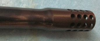

Some do work better then others. The drilled round hole, seems to make the most noise. .

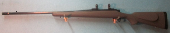

I have an 8lb 1986 Remington Custom Shop 700 300 Win Mag that I purchased used. The original owner had a local gunsmith install a muzzle brake on it. The muzzle brake turned this gun into a pussycat to shoot.

Try it with and without the brake once you've developed a load with the brake on then you'll see the difference..
Tames the recoil down so much aswell as the muzzle flip..
For snapshooting timed details shooting quick you need the rifle too stay on the target rather than jumping around..
Personally I prefer the brakes that send the blast rearwards being ported on an angle rather than 90 degrees..
Even less recoil..
I use a T3 terminator,a Roedale and 1other brake.
Similar angled ports just different designs.
All very efficient at reducing the recoil.
