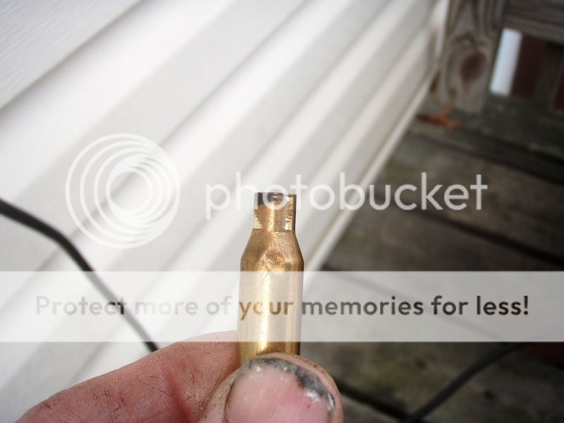

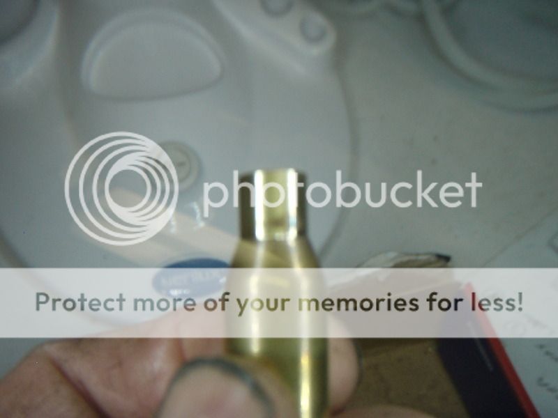

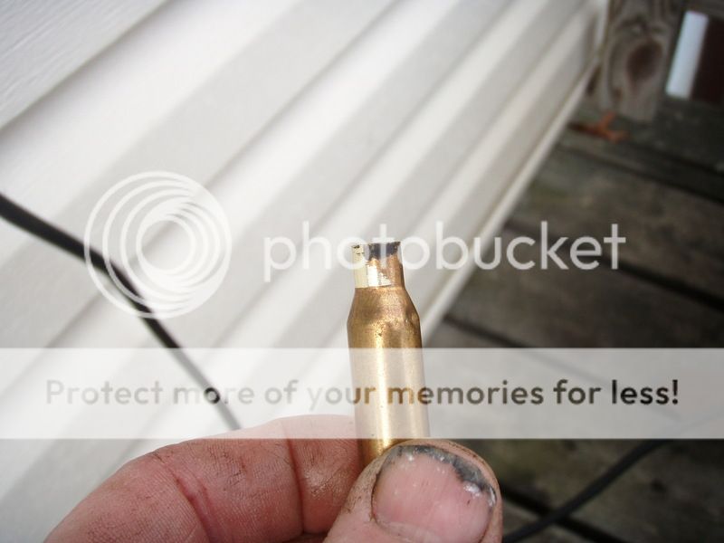

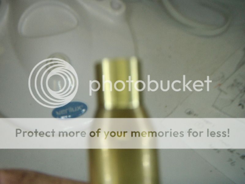

I don't have a really good clear pic , but here are 3 that I have . I seldom use steel wool , to smooth the finish . these did not get the steel wool treatment .
I found another pic .
Many thanks
I think my results are similar to yours, but your cutting lines appear to be closer together than mine. I suspect that I may be too eager with my feed-in.
Cam
yes , if you are to fast moving the cutter you will not get as fine of a finish as these . that's why I like to turn the case slow , I can keep up to it with my cutter feed easier . I'm sure someone has already mentioned that you need to cut down the whole way . I cut down until I just scratch into the shoulder , just enough to know I touched it . this way my cut tends to blend right into the shoulder . just use some old junk brass to practice on . if your good stuff is say 7mm-08 , any junk 7mm brass will be good enough to get the feel of your tools for cutting speed .

I turn the brass slow , I'm guessing 50 rpm . if you look at the pic of my drill I have the trigger screw turned in just about the whole way . then just feed the cutter accordingly , to get a nice finish .
better quality brass cleans up with little brass removal . Lapua and Norma seems to give just about 100% clean up with only cutting .0001 or .0002 ( a tenth or two ).
here are a couple pics of old junk brass I was messing with . if I remember right it was way out . the brass length must have been needing trimmed , I'm not getting the whole way down to the shoulder on this piece.
