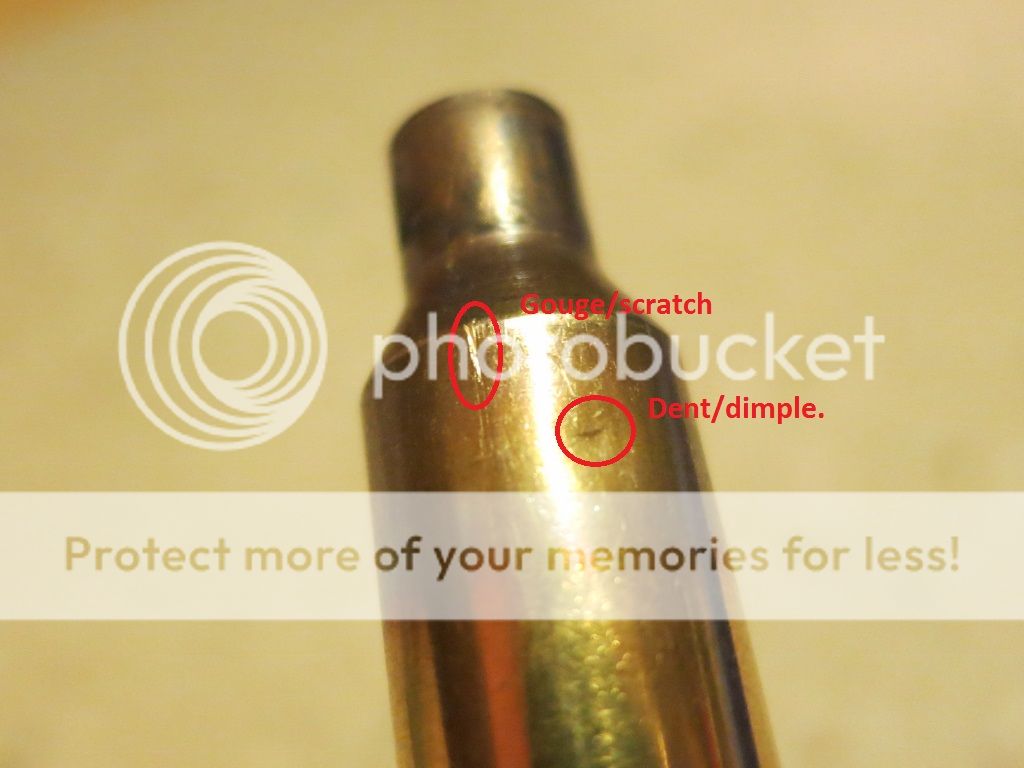

Another quick question if you will. What might be causing this:
It only happens WHEN FIRED. If I chamber and then don't shoot and remove the round, no dent or scratch in the brass.
I'm thinking it's something in the chamber that is scratchin' and denting it when the brass expands. Does that sound right?
The case is being scratched and dented on extraction. Both scratch and dent are on the same side, likely opposite the ejector. Without the bullet, the case comes out of the chamber at a sharper angle, gets dented against a locking lug when the shoulder clears the chamber then scratched by rubbing on the edge of a locking lug after the neck clears the chamber (or something like that :))
Is not caused by a defective chamber, you probably could lighten up the ejector spring or even remove it to solve the problem.
Thanks. You guys are really helpful here...I like this place already!
Good to know that it's probably not a chamber issue! I marked a round with a Sharpie by drawing a line from the neck and down
the body. I then inserted it at the 12o'clock posishun carefully. Fired the round and extracted it slowly. The scrape/dent are happening
at about the 1 o'clock posishun.
It's in a Defiance action with an M16 style extractor. Real nice & purdy action! The gun shud shoot once we git the throat elongated some more.
