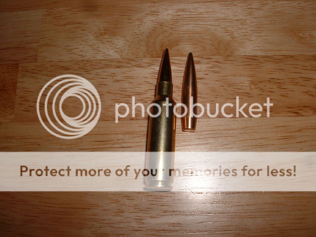

Here's a couple of photos.
To me this looks like it would be much too deep. I will be okay with the 145gr LRX's but will go with something else, like possibly the Berger 168gr Hybrid Hunter bullets if I can find any in Canada.
The second photo makes it look worse than it actually is because of the angle, but its a close representation.
Great pics. This really helps to see your situation. The solids have more length to make weight vs lead core bullets. Barnes must list loading data for their bullets. Do they give COAL info?

Guess I know little because both of those pictures scare me. Ignition looks like it would compress the bullet sides more than pushing the bullet out.
I throat so the bearing surface ends at the end of the case neck. To heck with short actions. If so, it's a single shot.
This is why it scares me as well, I can see it like you say, squeezing the bullet more than pushing it out, which to me could produce scary pressures.

Relax, seat to fit and feed from magazine and work up the load. Nothing weird will happen. The part of that solid copper bullet that is past the shoulder body junction will not deform and cause issues.
