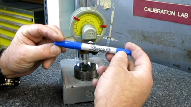

According to some testing done by the website 'hackaday', black sharpie is much, much thinner than the .0003 you think you are measuring. Below is link to their article which includes a YT video of their test.
Here is a summary of their findings from the article:
The results? Black, blue, and red Sharpie were all tested, alongside blue and black Dykem layout fluid. Ten samples of each were run and the readings were all very close, save a couple of obvious outliers. Clocking in the thinnest is black Sharpie at about 118 millionths of an inch (~30 microns) and blue Dykem was the thickest at 314 millionths (86 microns).
