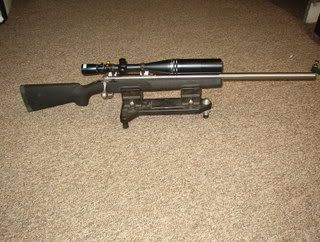

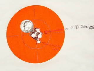

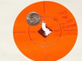

I have a LRPV in .223cal. It is by far the most accurate rifle,out of the box stock) I have ever owned. Ron
These groups were shot with a scope that wouldn't hold zero,and has since been sent off for repair. The gun is a shooter/with a great factory trigger, not common now day's). It is also extreemly heavy,and not a carry gun,unless your a weight lifter,Ron
