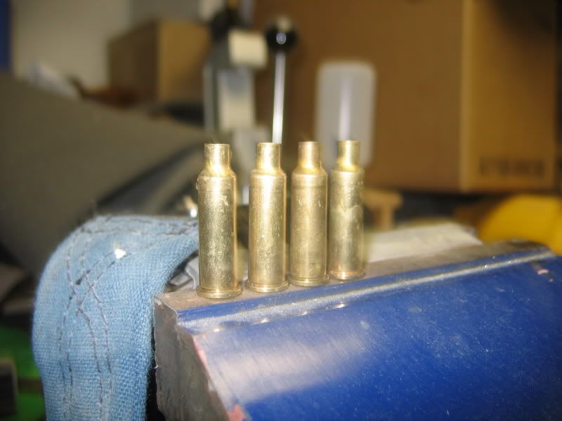

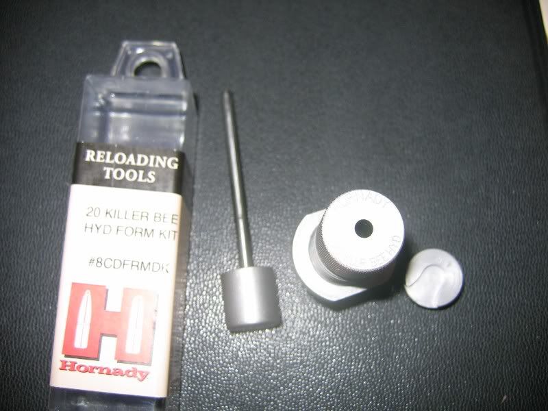

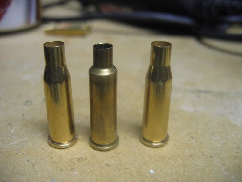

Frank i have used one to form .20 Killer Bee cases. Forms they out well probably 90+ %. One issue I had was the plunger rod was not tight enough and it allowed water to seep by without forming the case. Hornady really should make these from SS as when you get a bunch of water inside a die they tend to rust fairly quick.

Thanks for the reply and pictures. I called them yesterday and thought it was a good idea, at least in theory. I am looking into forming 30-338 Lapua brass to save wear on a barrel, and don't want to use the COW method. Do you think it will work with a case that big? I was trying to visualize how exactly it works, and was a little concerned with setting the die up in my press with water in the case, caming it over, and hitting that,plunger?) with a lead hammer?
