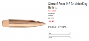

The Lapua 139's are easy to tune and can be hammers with a little load development. OK I'll say it Hornady 140 BTHP are about as good as the Sierra 140 MK's and fine for practice but will break your heart at matches with unexplained flyers. Another one to try is the Sierra 142 MK.
Midway still has the 142's for sale but Creedmoor Sports is less expensive:
$272 @ Midway
$250 @ Creedmoor Sports.
Might want to check around to see if someone else can better these prices...
