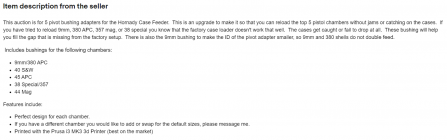

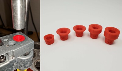

Well after reading the fleabay sellers description, i`m going to try these out. The seller seems to know what is needed for my 380acp case feeding problem.
