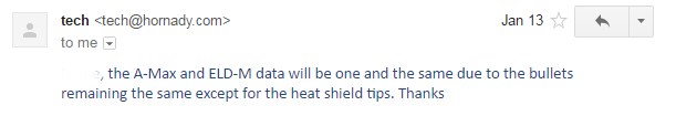

The ELD-M's are just the Amax with the new tips.....same/same.....
No they aren't. They are a different bullet.
As to the tips "melting", it's been hashed out a ton of times. They weren't melting but deforming in flight enough to effect BC. Proven on Doppler radar but there will always be people who don't believe it.
That I believe !!!
Maybe you guys should update Hornady tech......
By now it shouldn't surprise anyone what a company will do to reinvent something just to increase the price or relabel it into something "they say" is different. It happens all the time. I'm pretty happy with the price of the new replacement at this point as they could have been priced like the TMK or Nosler LR Accubonds. Ridiculously high. Thankfully Hornady realizes that affordability keeps people shooting.
I'll remeasure mine but initial check was they measured the same or within the same gray area as a lot to lot variation. These are all early release clearish tip eld though. 305-307 worked with amax and eld so far out to a mile.
I initially trusted the box numbers of 627\313 and took them to the lone survivor prs match and found out quick with the small targets out past 700 that number was too high. More tests were done after that and both a fast saum with fast twist and a slow 7mm-08 with slow twist yeilded 307.
Not sure who wrote that but I will make mention of it. Having personally spoken with the engineers who worked on the ELD bullet line I know they are not the same bullets. They have had slight design changes made to increase the BC as well as the tips. I think some confusion comes in as you can use the same AMAX handloading data for the similar weight ELD bullets but the billets themselves are not the same.
Really no big deal. There within the same basic ballistic profile for matching to the old version. My drop data is about identical. Whether Hornady techs say they are different or not really does not change anything. That's what they sell so that's what I'll buy and keep buying if they keep shooting well. I think most Hornady Amax/ELD shooters will agree.
