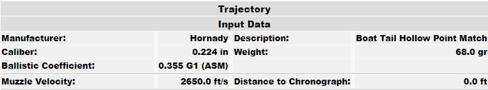

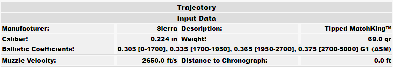

To find out, you could use the trajectory calculator at JBM Ballistics and select the bullet with "Litz" beside the name. The ballistic coefficients for the bullets with "Litz" beside the name were verified by Litz. The bullets with just the brand name use the BC's claimed by the mfg.

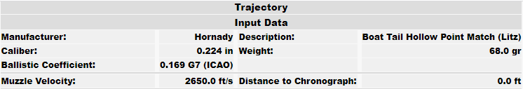

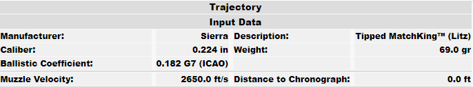

First, the Hornady using the Litz data for this bullet, which I think tracks my observations much better.
Wind deflection for a 10 MPH full cross wind at 300 yards is 6.8"
Then the TMK for the same set up is 6.3" which is a whole 0.5" difference at 300 yards.

When I do shoot the TMK bullets to 600, the Litz data tracks much better than the Sierra (or Hornady) data.
Here are the same data fields for these bullets using the OEM data, where the deflection is as follows.
Hornady 6.5" and TMK 6.3" at 300 Yards. With these BC values, the difference for 10 MPH is even smaller, but I get a better match to their 600 yard drops with the Litz data.
In my opinion, if the TMK and Hornady are shot from the same gun at the same speed, the TMK has a better BC by a slight margin and in both cases I find the Litz data tracks better than the OEM's.
