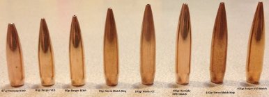

Here is a picture of the 105 Nosler Custom Comp, 105gr Hornady BTHP, 107gr SMK, and 105gr Berger VLD Match. ( plus some others) Placed and order from Powder valley so I thought I would get some for testing... Hard to beat the price.

Russ, thanks for that pic... saved me some $$ I'd otherwise spent on yet more bullets & shipping....
Looks like the Hornady 105's bearing surface is even longer than that of the 107SMK (0.392" Litz 2nd ed. p. 360) and Berger 105VLD (0.379" same source)? Meplats might benefit from uniforming / pointing up too... (note to self - borrow back Whidden tooling) and shorter OAL than the other two?
All credit of the picture goes to my Buddy Doug. ( hows that Doug?)
